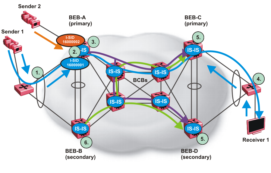

The following figure shows how multicast senders and receivers connect to the SPBM cloud using BEBs.
IP Multicast over Fabric Connect streams in an SMLT configuration
The following list describes the preceding diagram:
  1. The edge switch hashes the sender multicast data to a specific MLT link.
  2. A multicast stream received at the edge of the SPBM fabric is mapped to a dedicated multicast data I-SID.
  3. For the non-SMLT attached sender 2, the stream is hashed to the primary or secondary B-VLAN based on whether the data I-SID is even or odd numbered. For the SMLT attached to sender 1, IS-IS advertises the stream to the rest of the fabric on the primary B-VLAN and synchronizes information to the vIST peer.
  4. The edge switch hashes the receiver IGMP join to a specific MLT link.
  5. Both BEBs on both B-VIDs advertise the IGMP join.
  6. The multicast tree is built for (S1,G1), which is rooted in the primary sender BEB. The multicast tree is built for (S1,G1), which is rooted in the secondary sender BEB.
